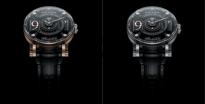

I completely understand what you talking about :slight_smile: I am aware of that, if I am gonna use maximum time settings I will achieve different samples in every frame. For example render like this took me render in 2560X1600 resolution almost 1 hour in custom settings. I am using CPU mode, cause to be honest I think results are much more better, and all the power is in my CPU. I would like to clash the time for 15 minutes or 20 minutes per frame, this is like the maximum. I want to create complete animation of movement and everything, these renders are in progress, and they are not finished yet :slight_smile: I want have this animation long like 30 seconds, and we cand o the math, If I am gonna use 30FPS thats like 900 frames and with current settings its 900 hours, thats like 37-38 days lol :slight_smile: I was thinking about render farm, but this is personal project and rendering this in render farm its wild idea haha :smile:
How long are you guys rendering 1 minute long animation? whats your average time per frame?

That looks nice!
Personally, I haven’t rendered any animation larger than 1920x1080. And for a minute-long animation, I’ve used a render farm. Usually a week with 256 cores or so is what I’ve done in the past. It’s not cheap, but these have typically been done for clients who were paying the bill. I would see if you can reduce the number of ray bounces and maybe try reducing some of your custom control settings to speed it up a bit. Maybe rely on a tiny bit of denoising?
Also, you can try rendreing it out a bit smaller, like 720p if it’s just a personal project. Then, you can try using a software to up-scale it. https://www.topazlabs.com/topaz-video-ai has some nice tools for up-resing. I don’t own it myself, but heard it’s good. And they typially run a great black friday sale, so next week, you could get it for pretty cheap.
Good luck! Nice watch images!
Just a tip on resolution. If you rendered a still and think you need a 2.560p resolution for it to look good, because that’s the size of the still image. You don’t need to use the same resolution for the animation, because the watch will look way better when in motion. Just render a short section with 720p like Will suggested and compare it with the still image. It will probably look almost as good.
